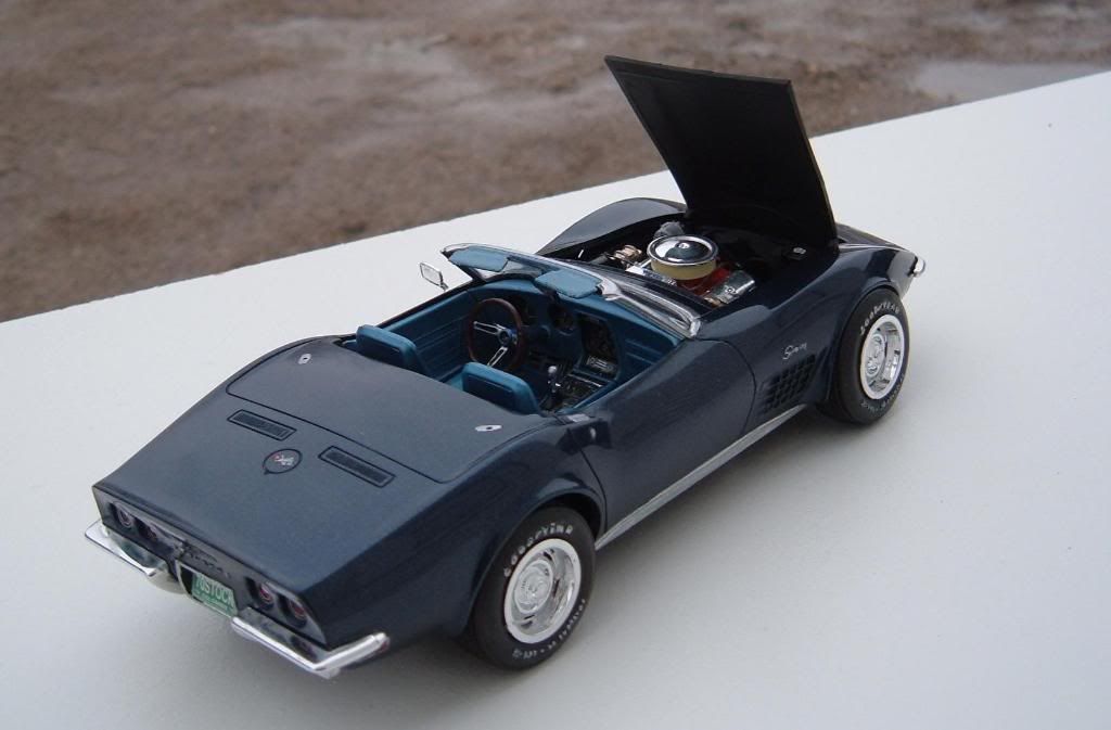

Snake45 Posted October 1, 2014 Posted October 1, 2014 This is Duplicolor, from the can, had "frosty" appearance shortly after shooting. Rubbed out direct, no clear coat.
