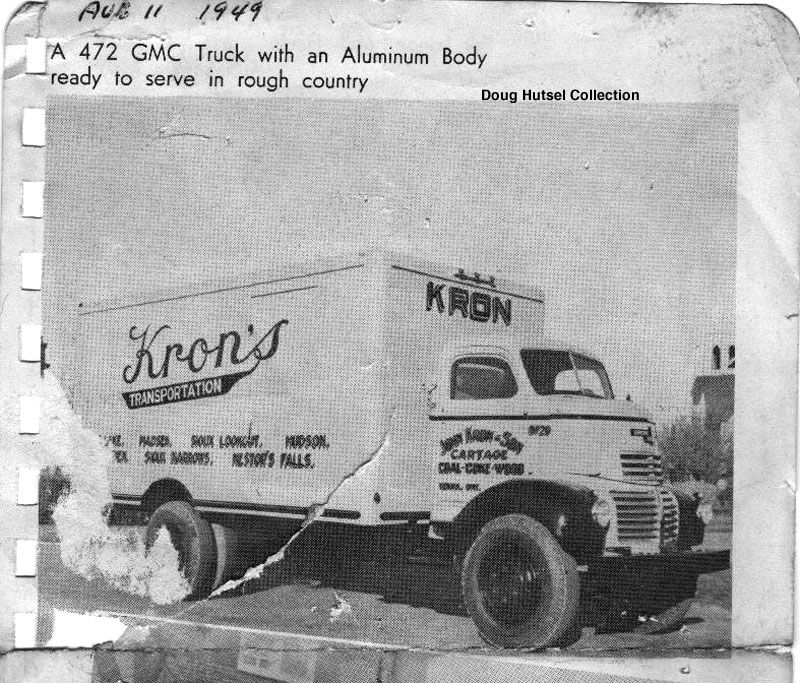

impcon Posted October 14, 2014 Posted October 14, 2014 Just wondering if anyone can suggest a software program for making up decals for 1/24 and 1/25 scale trucks? I'm not that great with computers so I need something fairly simple to make lettering for doors and van bodies. One feature that is especially important and desired is being able to print a company name not just in a straight horizontal line, but to place them in a curved, arch-like configuration as on the truck in the picture. Also, is it possible to mix different styles of fonts from different sites to form one word or a name? Any suggestions are welcomed. Thanks for reading.. I have been doing some reading and have learned some important things but I'd welcome suggestions for a program that makes working with different fonts fairly simple. It seems difficult to find someone who does this sort of work on a small scale ( quantity wise ) so I'll have to try it myself, I guess. Any suggestions are welcome.

impcon Posted October 15, 2014 Author Posted October 15, 2014 Thanks guys. the truck I want to build is yellow with black fenders and running boards and probably wheels. I'll try the Word program for fonts. I've had this project on my mind for years and have started it and shelved it a few times. It's important to me for my own satisfaction more than anything plus that truck that I am trying to replicate meant a lot to me back in my younger days and held lots of memories. I am still open to any suggestions though.
