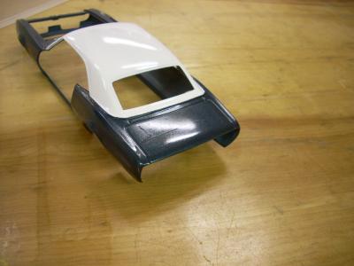

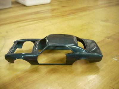

Chris D Posted November 9, 2014 Posted November 9, 2014 (edited) Hi everyone, I could use some advice here. I painted the car dark blue two weeks ago with Tamiya Acrylic paint. Today, I masked it off so I could paint the white top. As soon as the white paint was dry to the touch I removed the Tamiya masking tape and could see that the blue paint was really messed up. It looks like the tape glue left a nasty residue but it doesn't feel sticky or anything. It just looks awful and I am not sure what went wrong or how to fix it. Has anyone else had this problem and if so, how did you fix it? Here is what the paint used to look like.. Thanks for any and all help or comments. Chris D Edited November 9, 2014 by Chris D
cobraman Posted November 9, 2014 Posted November 9, 2014 I'm guessing that if you polish it when the paint is dry that will fix it. Someone may be along with better advise. Something like Goof Off may work but you would need to be careful you don't remove the paint. I don't think I would try that however.
StevenGuthmiller Posted November 9, 2014 Posted November 9, 2014 The only time I've had this sort of problem is if I try to "force dry" by setting the body in front of a heat source of some kind. I'm not sure if the heat softens the paint enough to leave marks from the tape in the paint or what. I never use garden variety masking tape on my builds any more. Way too many issues can come about with that stuff. I use almost exclusively Tamiya masking tape & blue painters tape, as well as masking paper. The less tape touching your paint the better. steve

JunkPile Posted November 10, 2014 Posted November 10, 2014 Hey Chris, I feel your pain. Same has happened to me a couple of times. Tamiya rattle can, Tamiya tape. The adhesive on the tape seemed to be like acid on the paint finish, and it would do it with just a momentary touch and remove test. Damaged finish beyond repair. Anyone else?
ZTony8 Posted November 10, 2014 Posted November 10, 2014 Your color coat may not have been fully dry or the tape adhesive was old. I've run into this problem when I used Tamiya lacquers(but not the acrylics).The lacquer is just hot enough to soften the tape adhesive if left on too long or a heavy,wet coat is applied.

Harry P. Posted November 11, 2014 Posted November 11, 2014 Even cheap masking tape doesn't leave marks like that. My guess is that the blue paint was not fully dry.
bobthehobbyguy Posted November 11, 2014 Posted November 11, 2014 Did you paint it with the tamiya rattle cans or airbrush the bottled. The bottled can take a while to drive
StevenGuthmiller Posted November 11, 2014 Posted November 11, 2014 Even cheap masking tape doesn't leave marks like that. My guess is that the blue paint was not fully dry. I agree. There was obviously something going on with the paint too. Sometimes it's hard to come up with a reason for these things. Could have been a combination of things. Steve Solution, and one I follow always: Remove any masking tape BEFORE the body shell goes into a food dehydrator or under any heat source. That's how I've done it since I ruined a body shell by using 100-watt lightbulbs to force the paint dry without removing the masking tape beforehand. Art In the winter, I set a lot of parts in front of the fireplace in my family room to dry paint or glue faster. That's how I found out that heat & masking tape don't mix. Steve

Chris D Posted November 11, 2014 Author Posted November 11, 2014 Update... To further clarify, the color coat was shot about 2 weeks prior, and the clear coat (tamiya clear) was shot about 1 week prior to the "masking tape" event. Bother were bottle paints and airbrushed. Both were thinned with the Tamiya thinner for acrylic paints. Just air dried at room temperature in a fairly dry atmosphere - fall in Illinois is generally dry air time. Here is the crazy part, I just went out to the garage to study this problem further and it wasn't there! The car was there but the problem is mostly gone!!!! Some elves must have got in the shop and polished the car up pretty good. Upon careful inspection, there are still some small marks here and there, but all the nasty stuff that showed up in the photo is gone. I can almost see where the ends of the tape pieces were but that is about it. I suspect the adhesive did something to the clear finish (which must not be fully cured yet). After sitting for the past day and a half, the clear cured more and the chemical reaction went away in that curing process. Just grasping at straws for an explanation, in either case I am glad it seems to be getting better. Maybe by next weekend it will be completely cured! Thanks to everyone for all their comments, ideas, and suggestions. Chris D.
