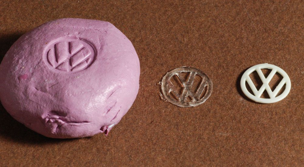

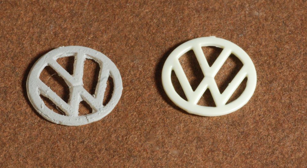

Foxer Posted March 27, 2015 Posted March 27, 2015 (edited) The Bondic came and I had a good test as a quick casting compound. I can't afford to use resin because my casting needs are few and far between and doesn't justify what would be 30 years of casting resin for a few hubcaps once or twice a year. I have resin probably 20 years old sitting on a shelf .. I know .. it's too old. So I chose the front VW logo from Revel's Samba kit. I bought the kit just for that separate logo to use on a build of my Dad's '56 Bus that I couldn't paint the cast on logo to my satisfaction. I did all this today! I made a mold with RTC silicone 2 part Mold Putty (this IS 20 years old too but still works). I 'drew' the logo with the Bondic .. moved the application pen around the letters trying to not get any between them. It has a nice consistency ... a little thickish but flows out and levels well. I nudged it around with the tip to get it evenly placed. Then a 4 second light application ... well, I did it for about 10 seconds to be safe. Then I pulled it from the mold! It just popped out easily .. no stick to the mold at all. A part of the outer edge was missing .. so I put it back tight in the mold and added a small drop at the missing area. Cured it and popped out. Couldn't tell where I patched it! The photo shows the mold, cast logo and the original logo (in white). The Bondic is basically clear. You can see a little roughness around the edges which are my quick mold process more than anything. This photo shows the logo after I sanded it a bit. It sands like plastic. The material is a bit flexible ... you can bend it without breaking. I also cut out some with the knife where it spilled over the mold. Easily trimed like plastic. This is after a coat of primer. It does need a little light sanding, but I'd call this done and useable. Very nice! So, I feel Bondic is another good tool to add to the arsenal we usr building cars. It's quick and easy for those little things we NEED! I haven't tried it yet as a bonding agent .. Edited March 27, 2015 by Foxer

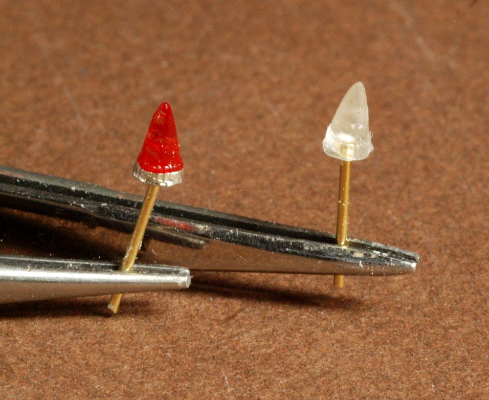

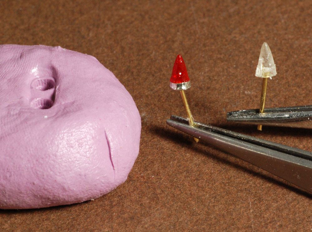

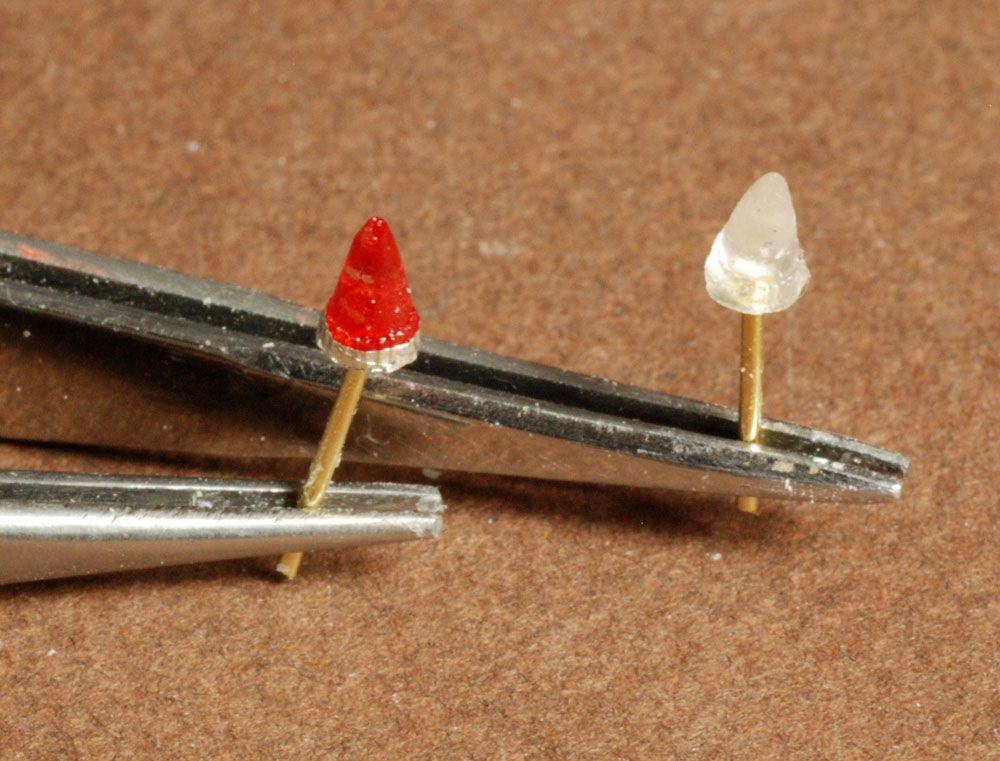

Foxer Posted April 3, 2015 Posted April 3, 2015 (edited) Another test. I did a cast of the 59 caddy tail lights from the AMT Merc. I just remembered I didn't put the original in the photos but no big deal. I colored one red with a Sharpie and added some BMF .. quickly as you can see. The gloss as they came out of the mold got dulled by my tight grip on them as I drilled a hole for a brass rod holder. The Bondic wasn't as soft as I though when I drilled .. harder than styrene it seemed. You can see the dullness on the clear one. I sprayed a quick Testors One Coat on the red one to shine it up .. no reaction from the spray. The red one got a couple small air bubbles that must have been my stabbing the liquid with the applicator to be sure it went all the way into the mold. It shows in one photo as a bright white spot. Test Results: PASSED! Edited April 3, 2015 by Foxer

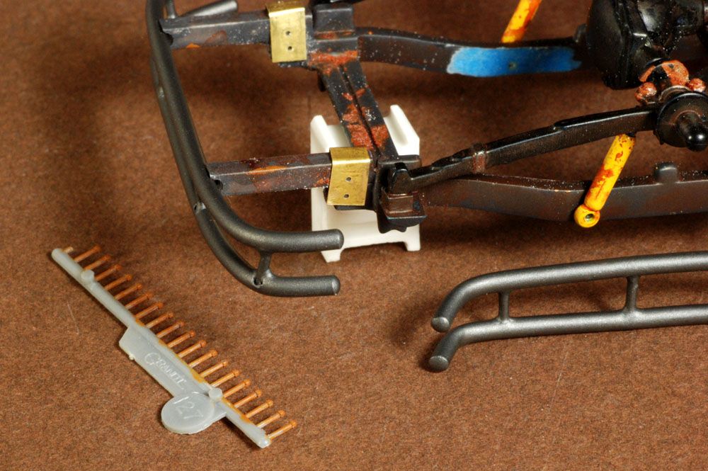

Foxer Posted April 29, 2015 Posted April 29, 2015 Here's my latest use of Bondic ... I made a bumper from aluminum tubes and needed to finish off the open ends. Normally I probably would have plugged the holes with some body putty ... let dry overnight.. and then sand flat and paint. These I just filled the hole with Bondic and let it form a raised bubble shape then hit it with the light. I didn't sand or touch it before painting this time. The ends are just perfect to me with their rounded shape. Nothing could have been as easy.
