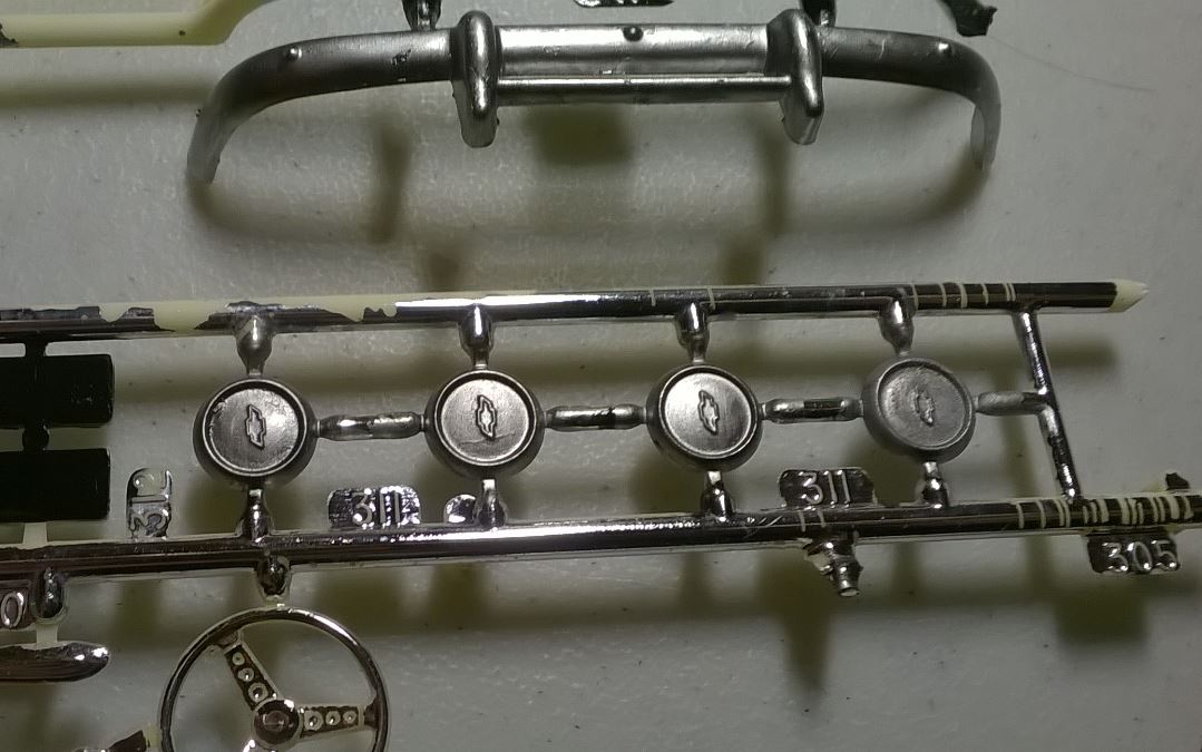

Tony_B Posted December 31, 2014 Posted December 31, 2014 Morning everyone, OK...what am I doing wrong? I've got the AMT '51 Chevy kit and I sprung for the expensive Spaz paint (including the gloss black sealer). However, my chrome looks just plain old silver. Was it because I brushed it on? (don't have airbrush yet....) ?????

Erik Smith Posted December 31, 2014 Posted December 31, 2014 (edited) Not sure about Spaz, but Alclad does require a gloss black base - preferably an enamel. Then light sprayed on chrome. I don't think brushing works with these type paints because of the way the tiny particles adhere to the black base. It's kind of like magic. I have another question - why were you trying to chrome those hubcaps on chrome sprue? I would recommend removing the parts, cleaning up mold lines and attachment points, then primer, base black, chrome. Black sealer? Is that the black base coat? A dealer sounds like something you put over the chrome... Enamel base coats allow the chrome paint to "bite" the undercoat and provide a more durable finish. You can get very good results with a lacquer base, but the chrome will be very susceptible to rubbing off. Edited December 31, 2014 by Erik Smith

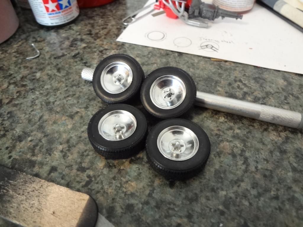

TFchronos Posted December 31, 2014 Posted December 31, 2014 I used Spaz Stix Ultimate Mirror Chrome Spray can paint and it works beautifully, reference picture below. Just spray in light coats over a gloss black base, I used Rust-O-leum X2 cover Gloss Black for these rims. Link to product http://www.amazon.com/gp/product/B0015H1FGA/ref=oh_aui_detailpage_o02_s00?ie=UTF8&psc=1

Guest Posted December 31, 2014 Posted December 31, 2014 I used Spaz Stix Ultimate Mirror Chrome Spray can paint and it works beautifully, reference picture below. Just spray in light coats over a gloss black base, I used Rust-O-leum X2 cover Gloss Black for these rims. Link to product http://www.amazon.com/gp/product/B0015H1FGA/ref=oh_aui_detailpage_o02_s00?ie=UTF8&psc=1 Now that is some very convincing chrome from a spray can!! How many coats did you spray Jonathan?
TFchronos Posted December 31, 2014 Posted December 31, 2014 Now that is some very convincing chrome from a spray can!! How many coats did you spray Jonathan? I did around 6 to 7 very light coats 20 to 30 minutes between coats with the can about 5 to 7 inches away from the rims when spraying. Something I should mention is that directly after spraying it will likely have a fogged look, let it dry for at least 12 hours then take a dry Q-tip for small objects or a cloth (cut up t-shirt) for larger objects and gently buff it, it should shine up beautifully.
