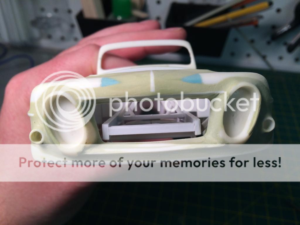

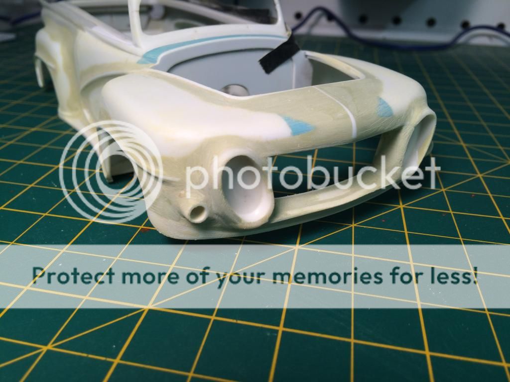

Impalow Posted February 14, 2015 Author Share Posted February 14, 2015 Thanks foxer.. I finally got around to that grille and some filler.. Still a long way to go, but I got the one side and the front rough sculpted. Quote Link to comment Share on other sites More sharing options...

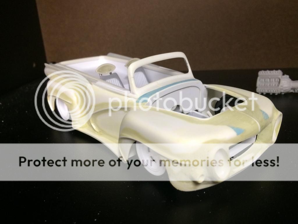

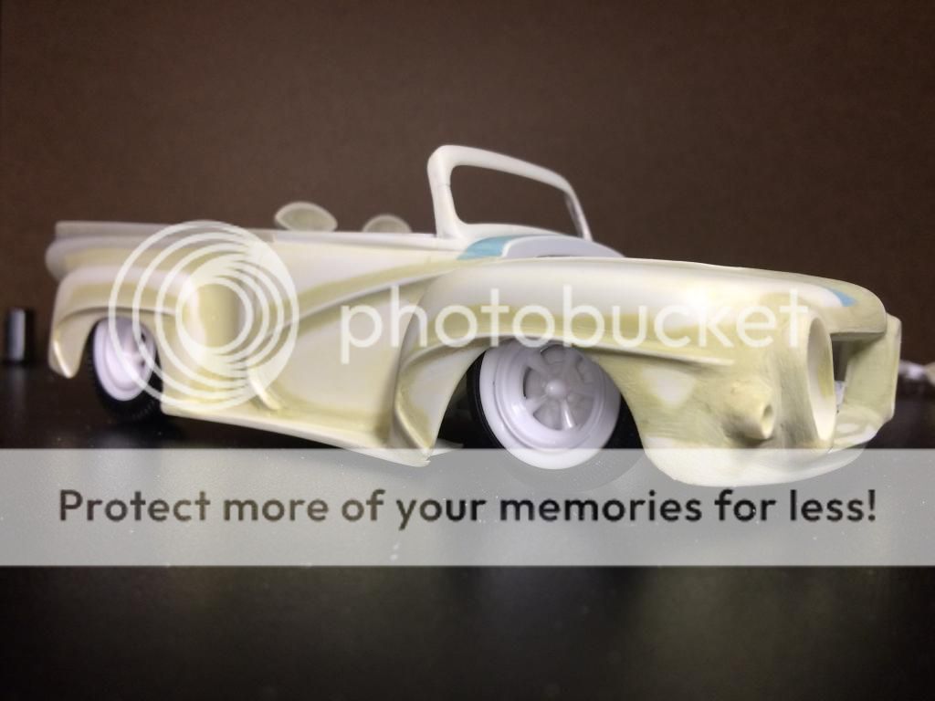

Impalow Posted February 14, 2015 Author Share Posted February 14, 2015 Thanks James! I'm still working out the kinks in the styling but the last picture makes me feel like I am at least on the right track. I think with a tubular bumper the front will come together, currently i cant stand the headlights being the furthest thing out. I am finding it hard to dance the fine line between pretty and vintage custom..Let's face it, a lot of these vehicles really werent "pretty"... but... i still love all of them. Its just a type of over the top design thats pulling me out of my comfort zone, I am enjoying the challenge. Quote Link to comment Share on other sites More sharing options...

James2 Posted February 14, 2015 Share Posted February 14, 2015 Have given thought to some Ed Roth style bumpers? Quote Link to comment Share on other sites More sharing options...

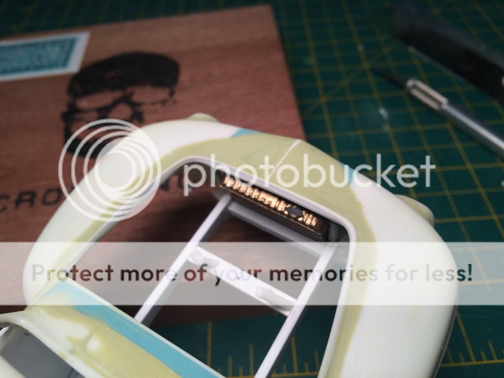

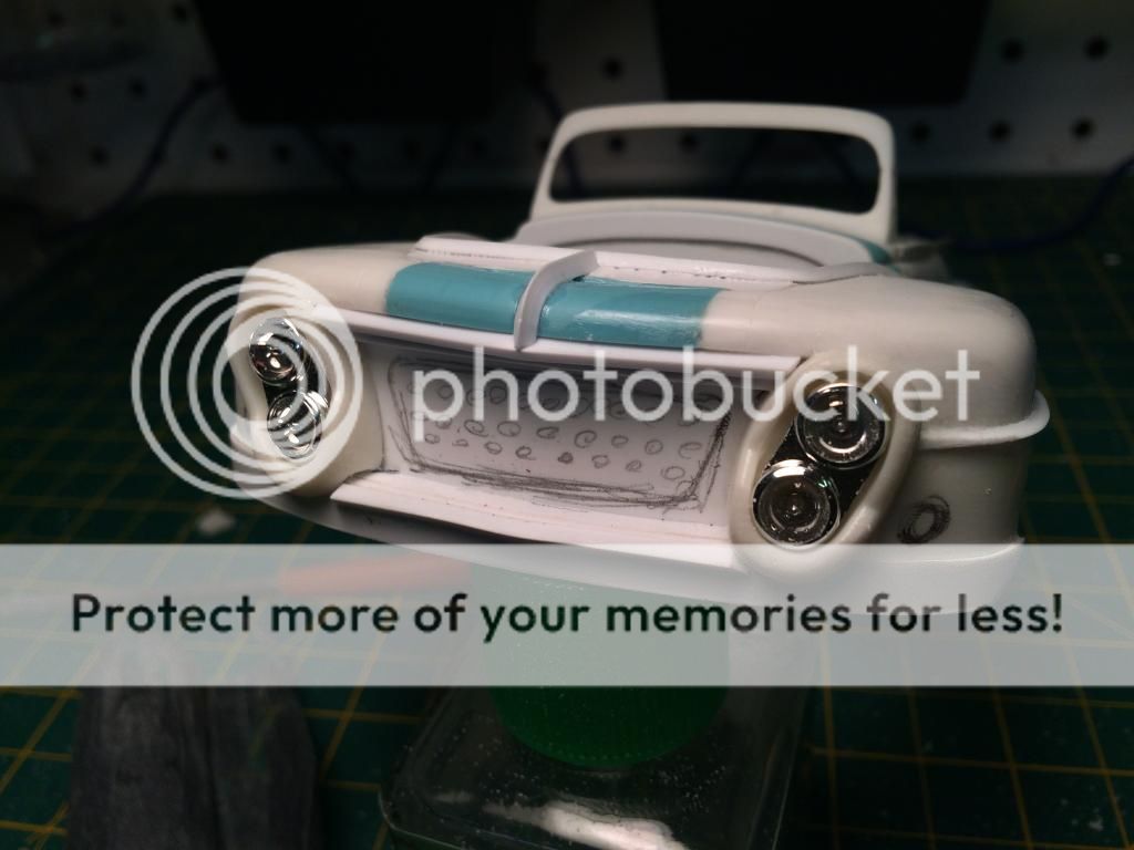

Impalow Posted February 14, 2015 Author Share Posted February 14, 2015 Will be interested in seeing how you do the grill The plan is to at least try a floating door knob/(pin head) grill with chrome trim. Have given thought to some Ed Roth style bumpers? James, That is exactly the type I was thinking! Quote Link to comment Share on other sites More sharing options...
crazyjim Posted February 14, 2015 Share Posted February 14, 2015 Hey Eric - I've done a couple pin head grills and found the easiest way is to run a short piece of telephone wire insulation onto the pin, push it through some fine mesh already cut to size and installed. Put another piece of telephone insulation on the back side and hit it with some CA glue. Quote Link to comment Share on other sites More sharing options...

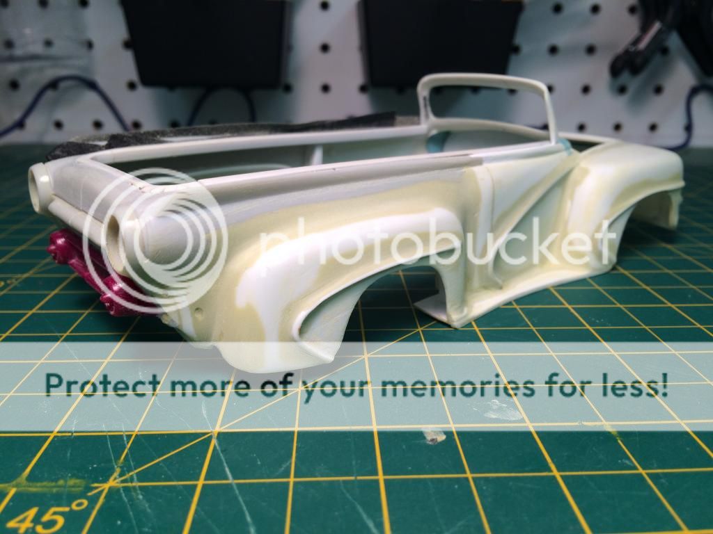

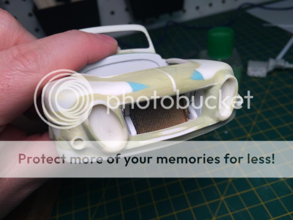

Impalow Posted February 16, 2015 Author Share Posted February 16, 2015 Thank you Jim! That helps a bunch... I just ordered the MCG offset circle photoetched grille material, and I have 2 types of pins, round and oval head... So hopefully I can make something out of all that. I managed to get the rear end filled yesterday, just one more side to go and I can get some primer on this bad boy. I decided to use high build 2 part automotive primer on this since there isnt much body detail left, so once thats on and sanded i will have to add all the detail back in (trim, bone lines, etc.) Quote Link to comment Share on other sites More sharing options...
Lunajammer Posted February 16, 2015 Share Posted February 16, 2015 I admire your putty throwing. I know how time consuming it is to sand and shape in those tight, recessed areas. I"m still trying to get on board with the door character line, but as you said, over the top isn't always pretty but it's true vintage. Fantastic craftsmanship and perseverance. Please keep going. Quote Link to comment Share on other sites More sharing options...

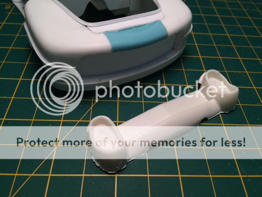

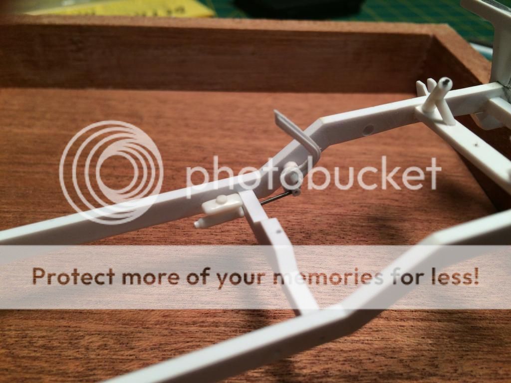

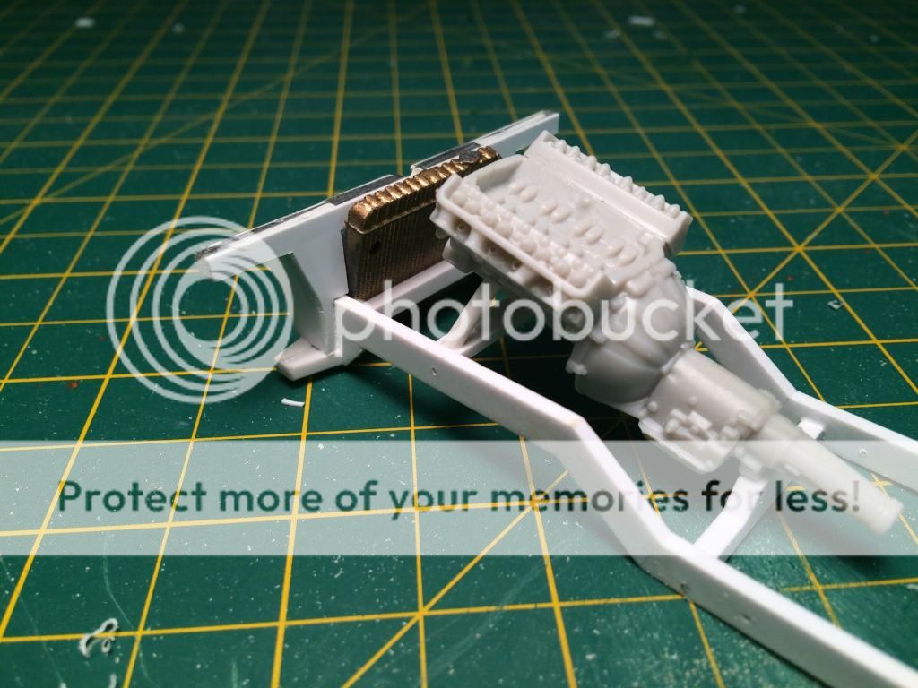

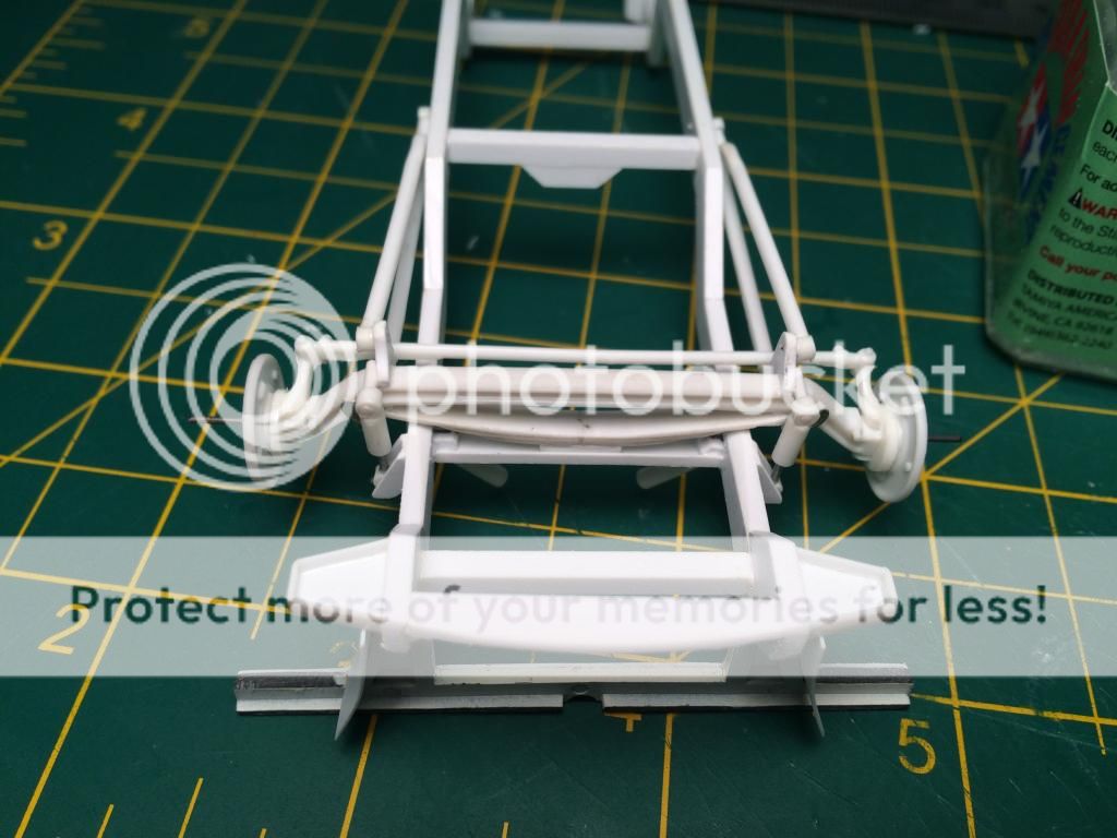

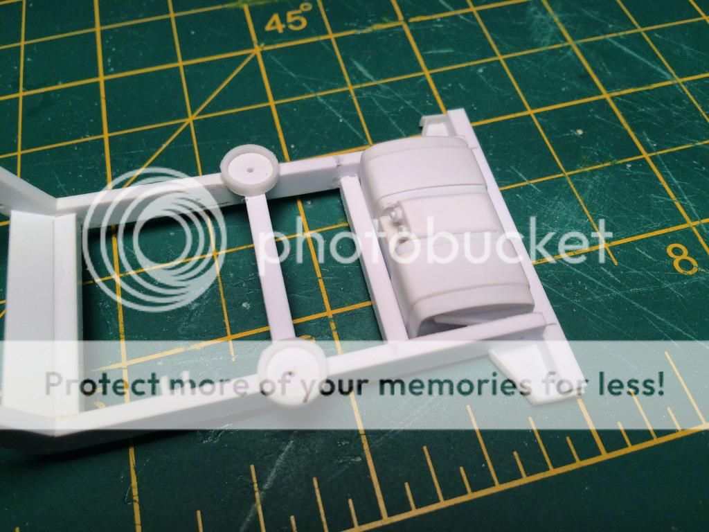

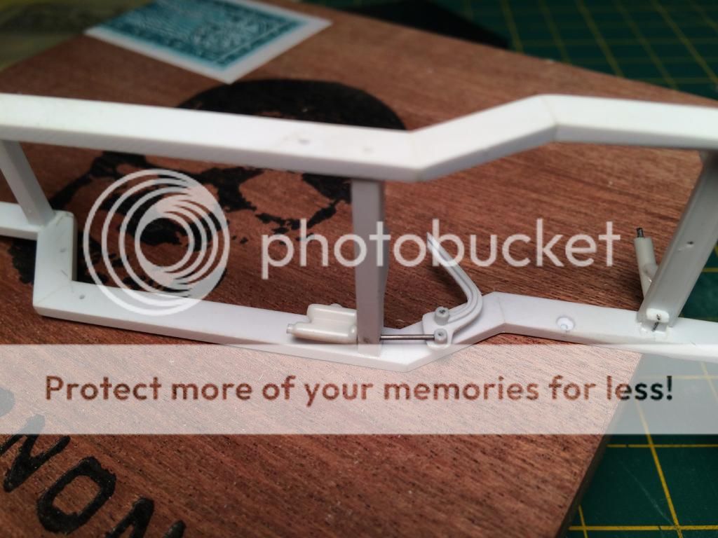

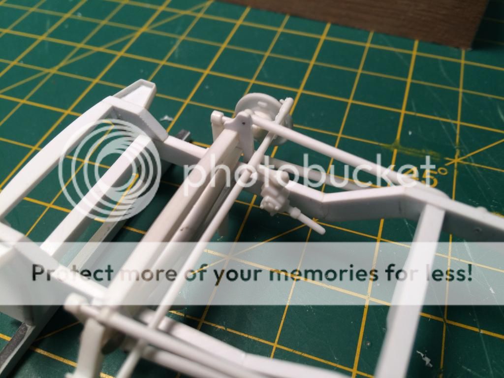

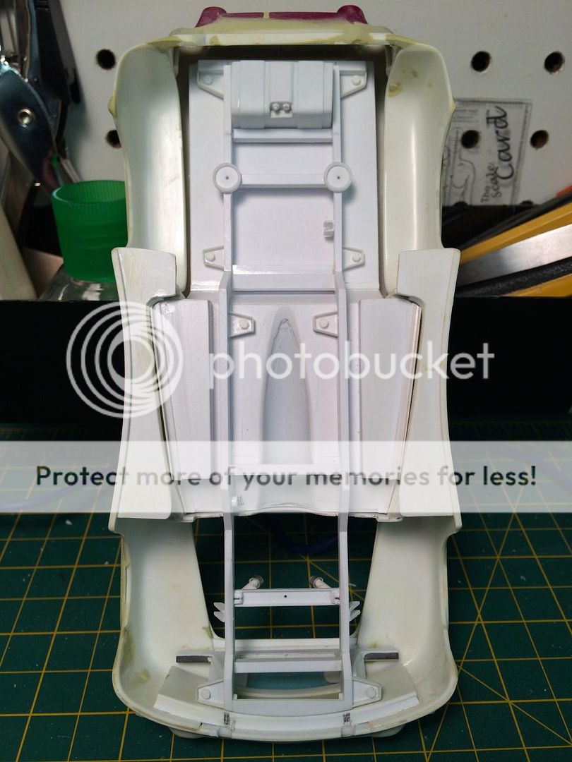

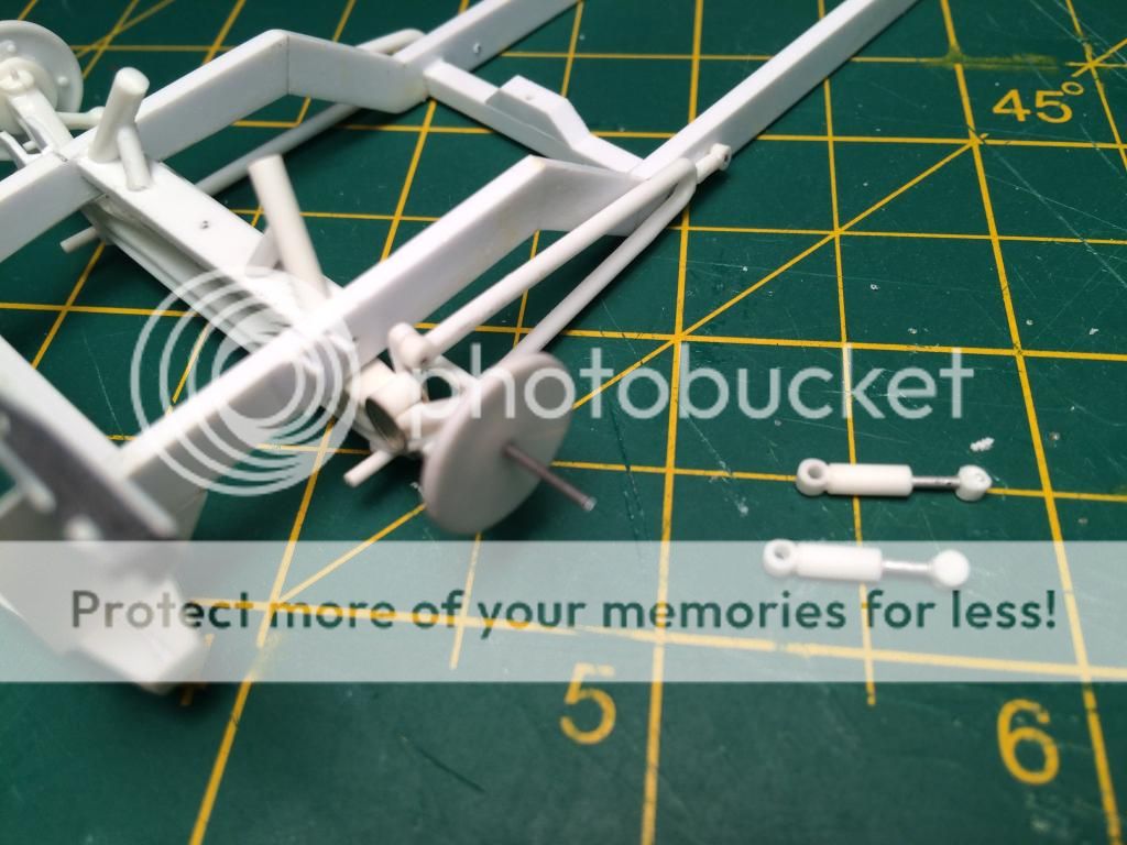

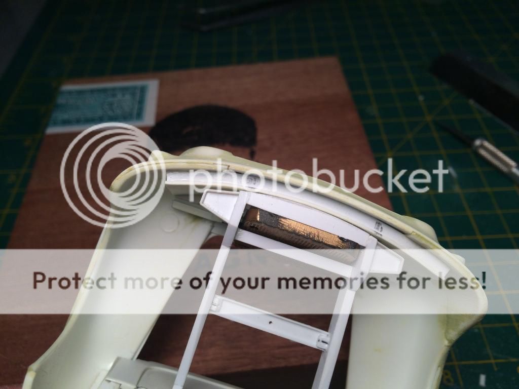

Impalow Posted February 23, 2015 Author Share Posted February 23, 2015 (edited) Please keep going. Thank you mike, im trying.... The body work is about 95% complete, so I decided to focus the last few days on wraping up the loose ends on the chassis. Upon test fitting the body and frame after the grille opening was cut out, i realized i had a minor issue with the frame. I droped the front frame ears downward and rebuilt that area, then added the radiator and core support from the 59 caddy kit. Then scratch built some body mounts much better.. Skinned everything with .010 styrene, and made air diverters to seal up the sides Shocks and shock mounts added. Then steering box and linkage Tonights goal = motor mounts and master cylinder. Edited February 23, 2015 by Impalow Quote Link to comment Share on other sites More sharing options...

Impalow Posted February 25, 2015 Author Share Posted February 25, 2015 Thank you Matthew! Im still thinking about the windsheild, I like your suggestion... a wrap around sounds really interesting. I want to try and keep some of the truck character, but that could really look great. Thank you for the kind words Christopher! Welp boys and girls... this was fun.. moving on to the fuel tank next. Quote Link to comment Share on other sites More sharing options...

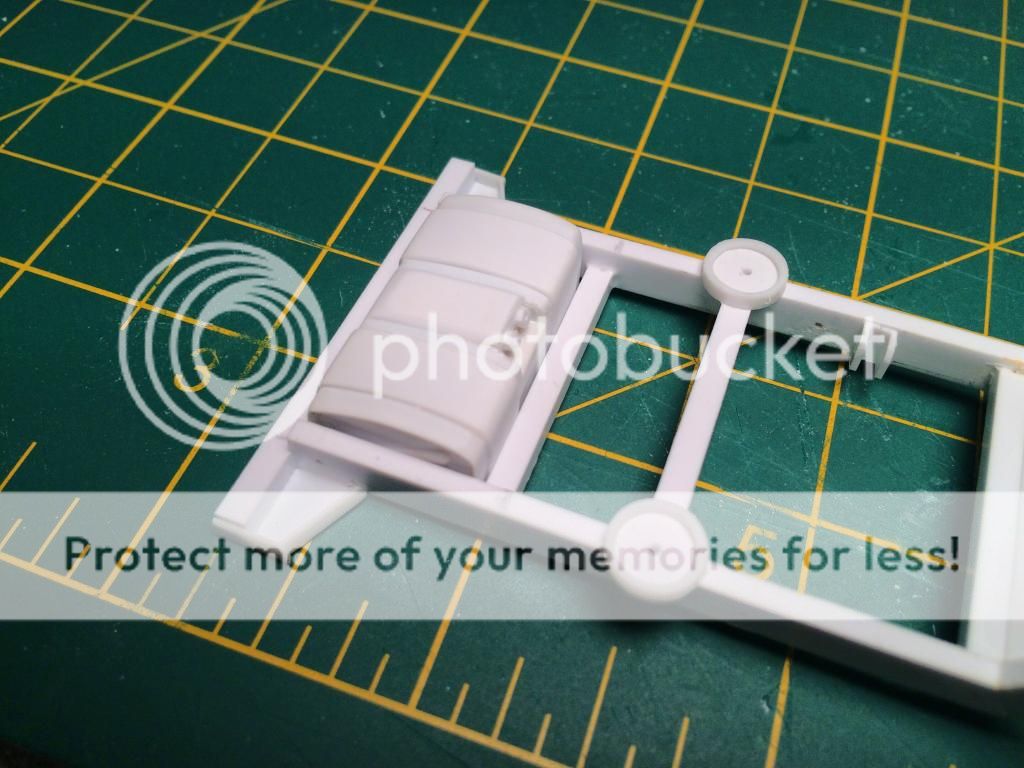

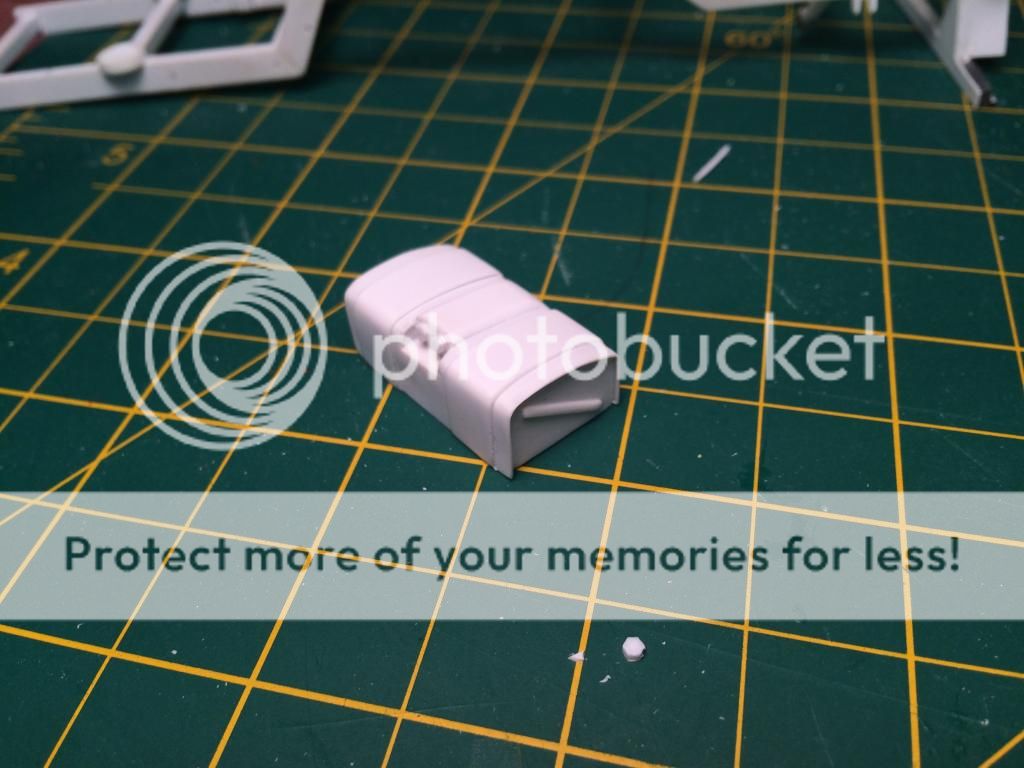

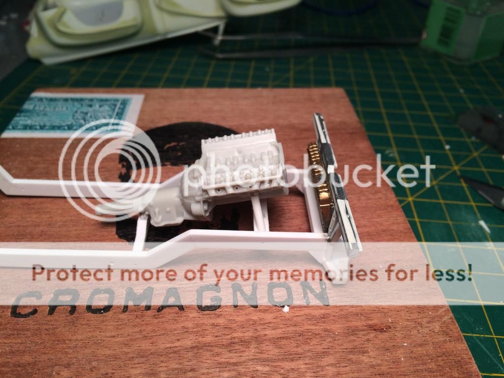

Impalow Posted March 2, 2015 Author Share Posted March 2, 2015 (edited) Thank you all for the intrest in this project! Progress has been a little slow this past week, mostly due to my own laziness. However, I managed to build the fuel tank last night, I think it is about 18-20 seperate little pieces of styrene in there. On a good note, I am a few body mounts away from calling this frame fabrication done. After that is complete I am going to shift my focus onto the engine and headers. Since the interior is my favorite part, im going to try and save that till last... if i can help myself. And boom... Engine shop opens tomorrow night Edited March 3, 2015 by Impalow Quote Link to comment Share on other sites More sharing options...
