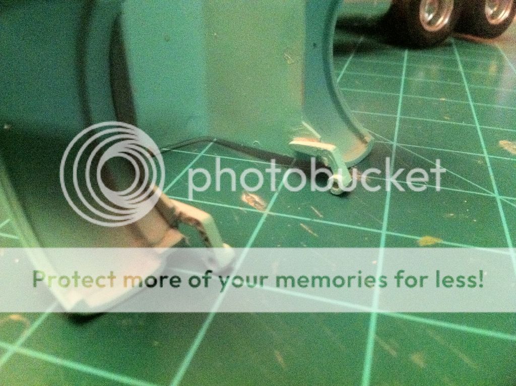

anarximis Posted June 9, 2015 Posted June 9, 2015 It's an original issue, but neither had hinges. I used some extra Italeri hinges and drilled out the front of the spring hangers. The tab on the bottom of the grill needs to be cut off also. ok do you happen to have a god picture of one ill most likely try to scratch build the hinge

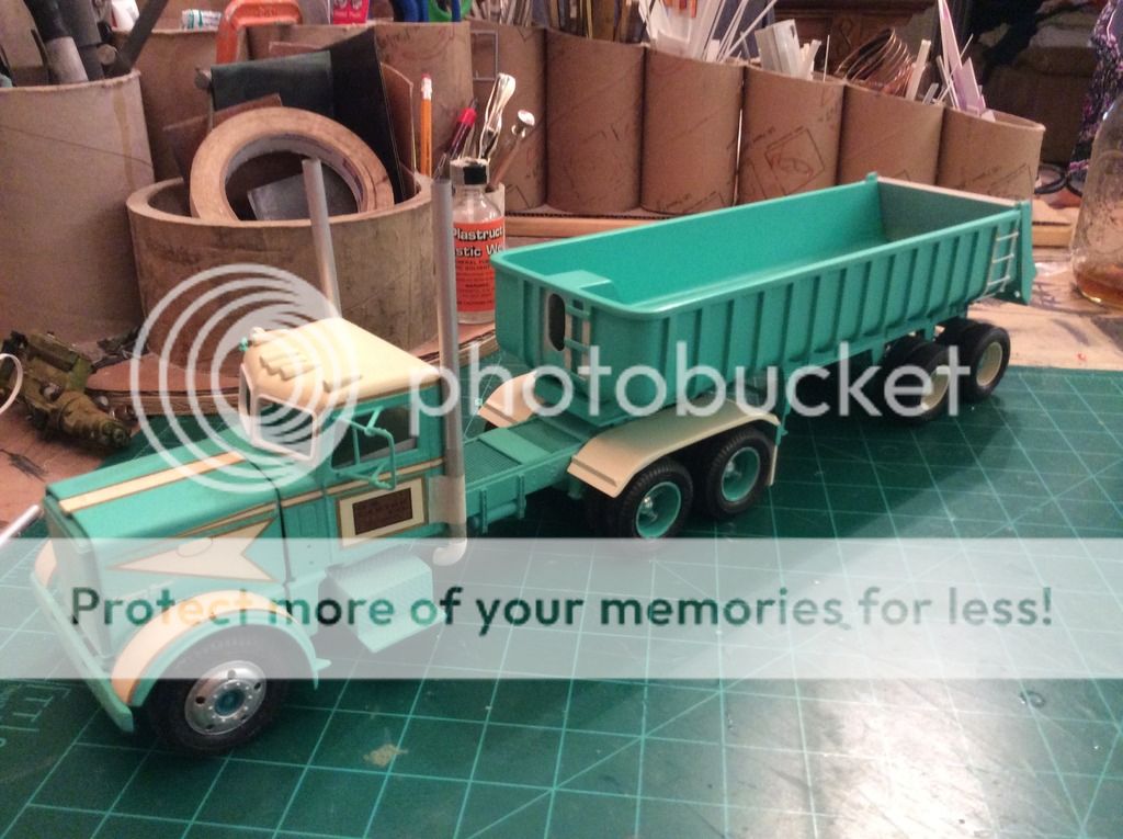

bandit1 Posted June 11, 2015 Posted June 11, 2015 nice pete...... I wonder those stripes running up on top of the hood and fenders don't appear to be kit stuff?... was that all paint??? Stupid wireless keyboard...urghhhh

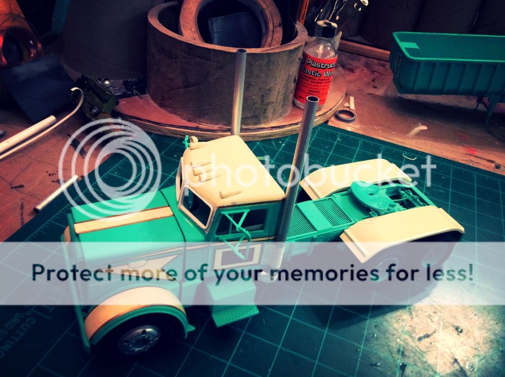

Superpeterbilt Posted June 12, 2015 Author Posted June 12, 2015 nice pete...... I wonder those stripes running up on top of the hood and fenders don't appear to be kit stuff?... was that all paint??? Stupid wireless keyboard...urghhhh Its paint and decal. I found a good match to the off white decal color. I painted the body this color first. Then clear, then traced the arrow decals, then masked, then painted green. The gold pinstriping is from my LHS.

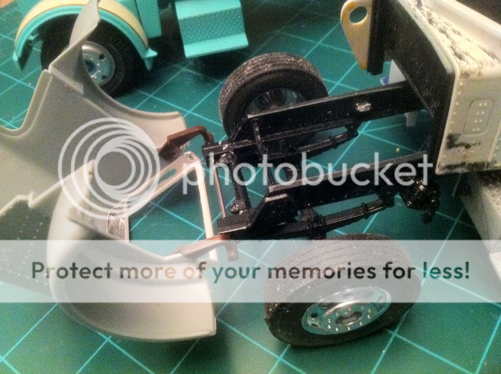

Superpeterbilt Posted June 12, 2015 Author Posted June 12, 2015 ok do you happen to have a god picture of one ill most likely try to scratch build the hinge Heres a shot of the hinges. Heres another one Im working on. These hinges are from the Italeri WS brown issue.

anarximis Posted June 13, 2015 Posted June 13, 2015 thanks for the pics of the hinges ill try to scratch build a set

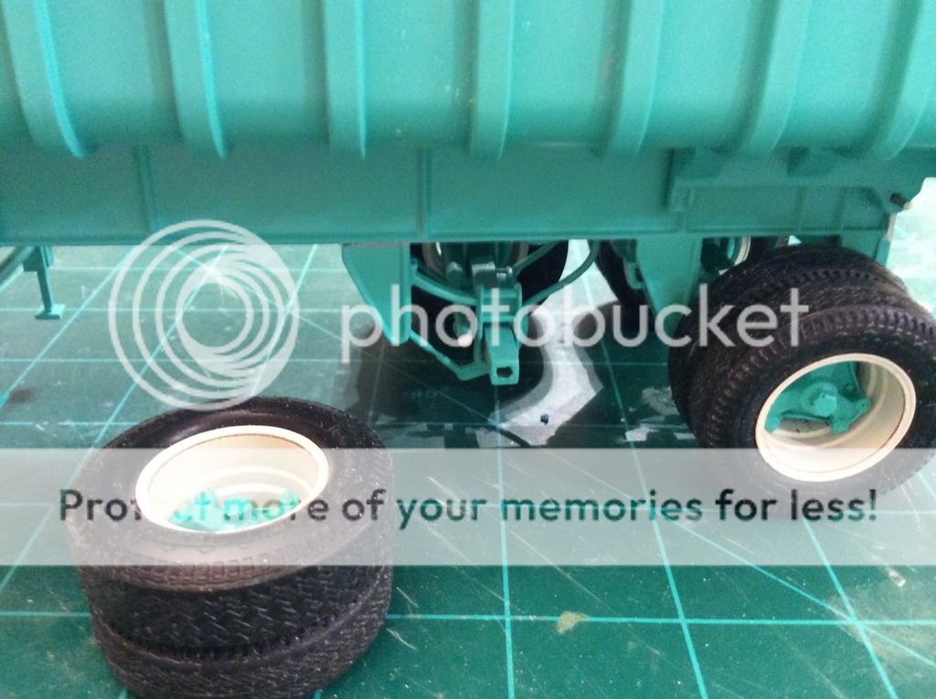

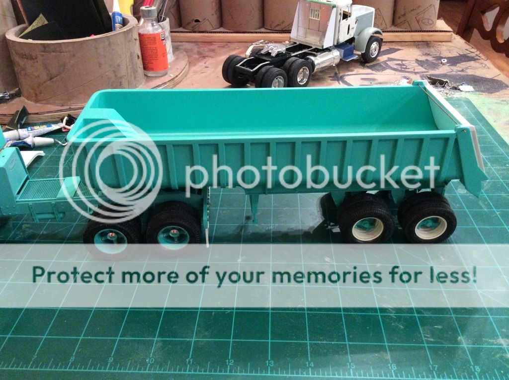

Superpeterbilt Posted June 14, 2015 Author Posted June 14, 2015 We'll, I bit the bullet and moved the front axle forward on the trailer. I need to replace the leaf spring. I'm happy with this spacing.
Guest Posted June 14, 2015 Posted June 14, 2015 I like your adjustment Terry. The spacing on the tandem suspension of the 1:1 trailer is 50", on a tri-axle it's 45" between axles. Assuming MPC was close with the tooling, then you should need at least an extra 5mm between axles (from center to center) in order to make it accurate. This was the main reason I used the suspension from an Exterior Post Van on mine, the axle spacing was more accurate. Chopping off the forward axle and not making the correction is actually quite noticeable, however you corrected that.
Superpeterbilt Posted June 14, 2015 Author Posted June 14, 2015 I like your adjustment Terry. The spacing on the tandem suspension of the 1:1 trailer is 50", on a tri-axle it's 45" between axles. Assuming MPC was close with the tooling, then you should need at least an extra 5mm between axles (from center to center) in order to make it accurate. This was the main reason I used the suspension from an Exterior Post Van on mine, the axle spacing was more accurate. Chopping off the forward axle and not making the correction is actually quite noticeable, however you corrected that. Thanks Anthony. It measures out at exactly 50" now.

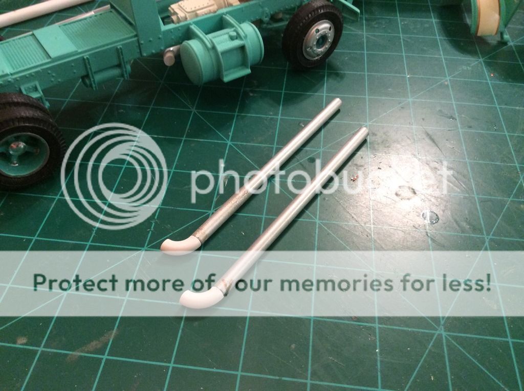

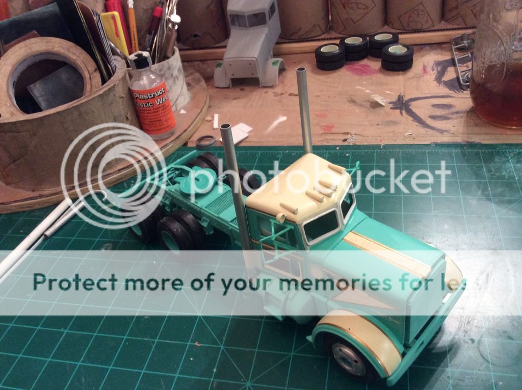

Superpeterbilt Posted July 5, 2015 Author Posted July 5, 2015 I finally started tackle the exhaust. The actual pipes are alum tube glued to plastruct elbows. The Y pipe is made from two elbows. I heated and bent .250 solid rod to make the pipe from the turbo to the Y.
