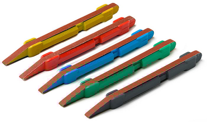

Mackvision Posted January 16, 2015 Posted January 16, 2015 I bought a set of these a few years back and really like them for "tight spots" they work great for me,especially on engraved trademarks and the like..............................Mark
