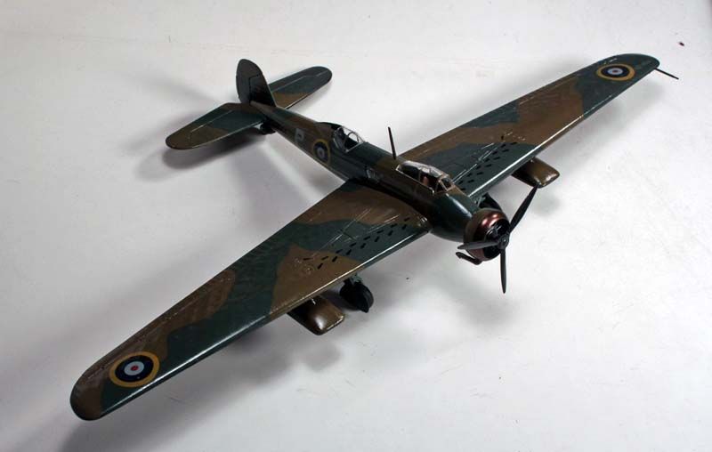

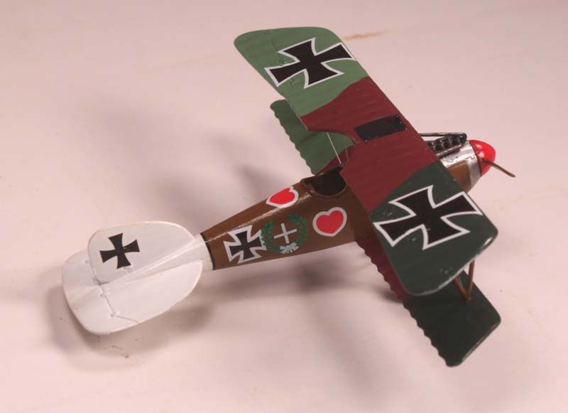

Aaronw Posted January 16, 2015 Posted January 16, 2015 (edited) I like MM Acryl, but except for rattle cans I use Acrylics almost exclusively so am used to them. Acrylics take some adjusting to, and they don't all work the same as you found with Tamiya. Personally my favorite paint for using with a brush is made by Games Workshop. It is marketed towards figure painters and has funny color names but it is great paint. I don't have many photos showing the use of brush painted acrylics on car stuff as it tends to be interiors, engines et which I don't typically get good photos of, but I brush paint a lot of the aircraft I build. The body shell was Tamiya rattle can, but the engine compartment is brush painted with acrylics. The wheels and fog lights were also brush painted. All of the following was brush painted with Model Master Acryl, Polyscale, or Games Workshop acrylic paints. Edited January 16, 2015 by Aaronw
