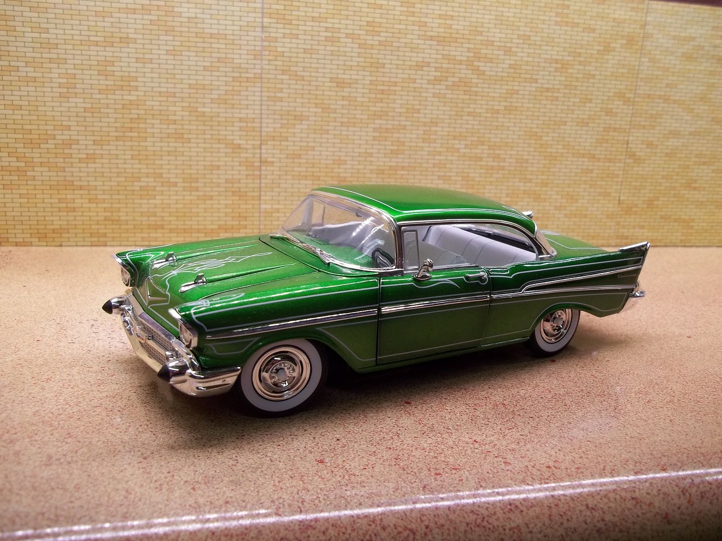

Longbox55 Posted January 19, 2015 Posted January 19, 2015 The Paint Shop clear, the one that comes in the quart can, is pretty nice to work with. I've done a fair amount of testing with it, and have found it to be very forgiving, and it works well over not only automotive paints, but also many hobby paints.This one is shot over Duplicolor GM black metallic with the Prismatic Metalflake midcoat. The red half is Kustom Kolor Transparent Red Apple.Same midcoat as above, but the base is Testors One Coat Inca Gold. This one was a little different experiment, The top is Metallic Clear midcoat, the bottom is the Prismatic, the middle has no midcoat. The base is Tamiya TS37 Lavender.Similar to the above pic, but this one was based with Duplicolor Silver metallic (I don't recall the exact color), the topcoated with Tamiya Acrylic Clear Blue. As you can see, the clear coat did not affect the acrylic at all.Dirty Donny Vantasy. The top and bottom colors are Duplicolor, the maroon band in the middle is Tamiya. It also has a faded midcoat of the Prismatic on top into the Metallic on bottom, then the whole thing cleared with the Paint Shop clear.Ignore the car, it's a die cast. But the floor of the garage in this pic, which is made from a laminate countertop remnant, is also cleared with Paint Shop. It first got a couple of mist coats in 3 colors of vinyl paint to replicate a Terrazo style floor, the clearcoated to bring the shine up. It has not been sanded at all, just cleared.
StevenGuthmiller Posted January 19, 2015 Posted January 19, 2015 I like the idea of the can of clear & airbrushing it on. You can get better control & a thinner coat with an airbrush, & with the quart can, I shouldn't have to buy clear so often. Plus, as I understand it, it's already pre-thinned & ready to spray, which is a plus! I'm definitely going to give it a try. Steve
