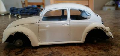

jacoballardtattoo Posted January 22, 2015 Author Posted January 22, 2015 (edited) Okay finally got some pics of my fender denting. I still have some detailing to do but wanted to get some responses first. Edited January 22, 2015 by jacoballardtattoo Quote

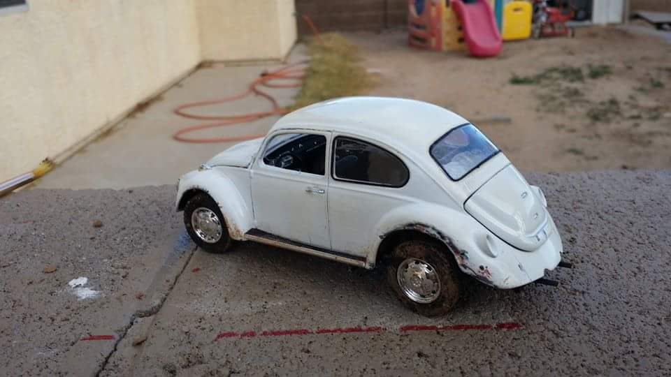

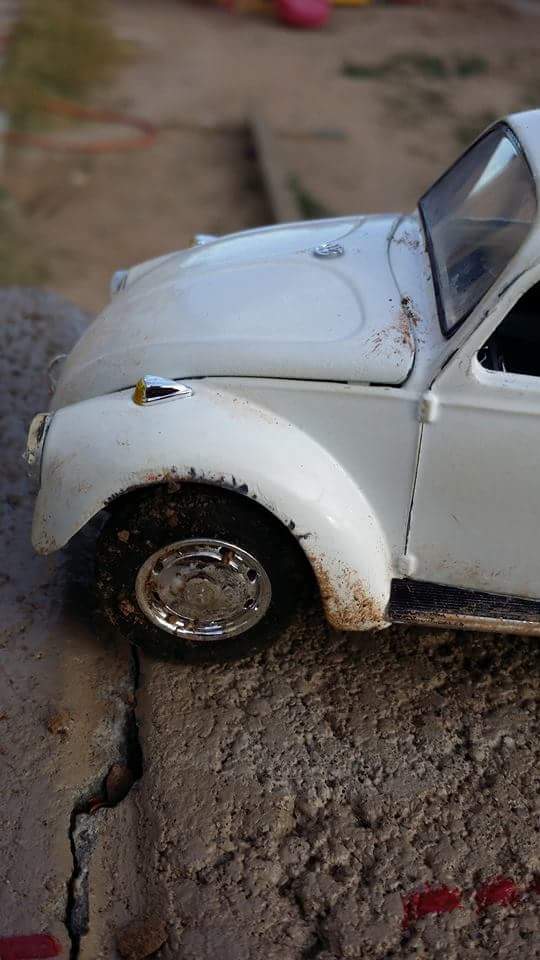

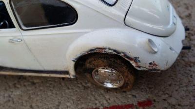

jacoballardtattoo Posted January 23, 2015 Author Posted January 23, 2015 Wow thank you everyone and thank you for telling me about the candle I see your point there very well. The light bulb is a great idea too. I am curious what you guys think about the dents I did, I love constructive criticism. Quote
Foxer Posted January 23, 2015 Posted January 23, 2015 (edited) Looks like that VW sideswiped a wall. Looks pretty good head on, but mostly like it was filed flat. An angled view would would give a better view of what you did. I'd be interested in a few more views. Edited January 23, 2015 by Foxer Quote
jacoballardtattoo Posted January 23, 2015 Author Posted January 23, 2015 Thanks Mike I see what you mean, I will try and get some more views posted tomorrow Quote
jacoballardtattoo Posted January 26, 2015 Author Posted January 26, 2015 (edited) So finally got some more pics, almost done. Edited January 26, 2015 by jacoballardtattoo Quote
