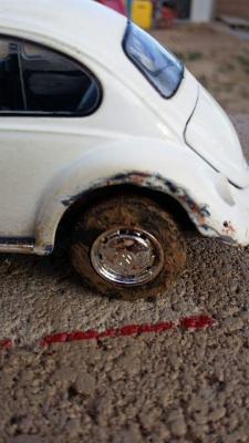

jacoballardtattoo Posted January 24, 2015 Posted January 24, 2015 So I just tried this out and I'm pretty happy with the results, (I don't have pics yet but will try and have them tomorrow) I ground up brown sidewalk chalk into rough dust, mixed Elmer' so school glue and water then painted the treed of my tires with the glue water, rolled the tires in the dust and had perfect muddy tires. Has anyone else done this? What we're your results?

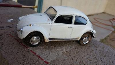

jacoballardtattoo Posted January 26, 2015 Author Posted January 26, 2015 (edited) Finally got some pics, the mud job is nothing in comparison to the Jeep but it's good for the car. Edited January 26, 2015 by jacoballardtattoo
