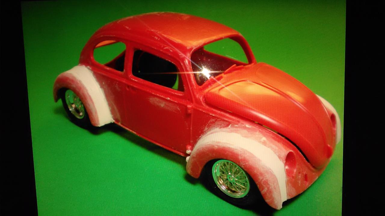

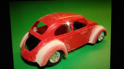

oneescalante Posted February 3, 2015 Posted February 3, 2015 nothing on the market as far as I can tell. Thats a spidey bug with a stretched cobra chassis. Fun build so far.

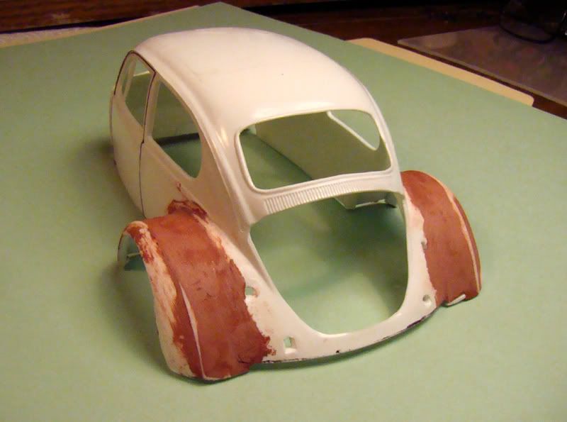

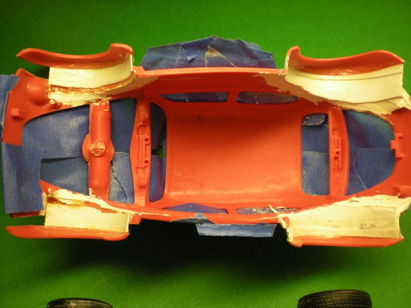

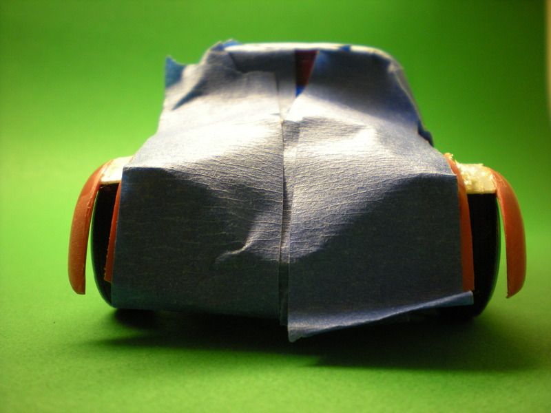

oneescalante Posted March 26, 2015 Posted March 26, 2015 (edited) Cool. What more can you share about your build? This is my 2nd widebody attempt. Cut the fenders off as close and straight to the body. Glue in some sheet to the body at the inner wheel wells to fill the void. Set your fenderless body on the chassis. Glue the back fenders on, let the glue tack up just enough to adjust without falling off. Hope that helps. Cheers! Van Edited March 26, 2015 by oneescalante
Lunajammer Posted March 26, 2015 Posted March 26, 2015 (edited) This is my 2nd widebody attempt. Cut the fenders off as close and straight to the body. Glue in some sheet to the body at the inner wheel wells to fill the void. Set your fenderless body on the chassis. Glue the back fenders on, let the glue tack up just enough to adjust without falling off. Hope that helps. Cheers! Van I did something similar. Extending the fenders is pretty easy really. More so than establishing the stance. the compound curves are friendly to sanding. Edited March 26, 2015 by Lunajammer
