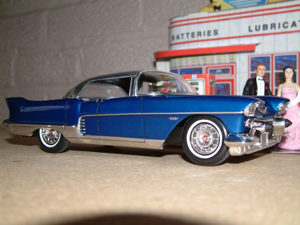

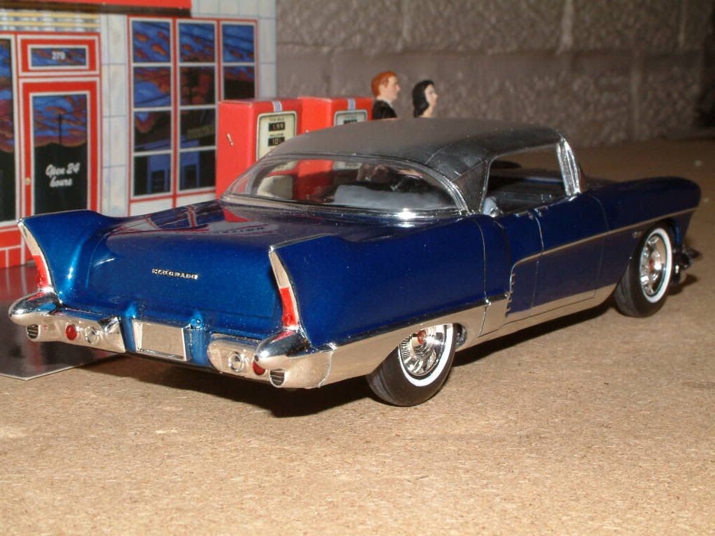

MrObsessive Posted February 14, 2015 Posted February 14, 2015 (edited) This is just me, but I always thought that kit had some proportional problems. The width, length, relationship/shape of the roofline in proportion to the rest of the car, just never appeared correct to me. I tried building one back in the mid '90's with some corrections, but gave up on it. Might try to attempt it again someday. Now as Art said, with some time and patience, it can be built into something very nice. Gunze Sangyo did a 1/32 scale version years ago and while it's not the "correct" scale for many folks, it looks light years ahead in appearance as opposed to the Revell version. Might be worth checking it out........... Edit: Some pics for comparison.......... Revell's builtup as swiped off of Photobucket: And the 1:1....... Jus' sayin............ Edited February 14, 2015 by MrObsessive
72 Charger Posted February 14, 2015 Posted February 14, 2015 I have found that the 59 caddi chassis and engine bay fits quite well after a bit of shortening . Ive still not finished mine but im on the home strait . The rear edge of the hood is the wrong shape . Also the parcel shelf is wrong too. The front end needs a bit of work around the top of the bumper as well. Bill do you know who build that one you showed ? I would be interested in finding out where or how the badges where done
unclescott58 Posted February 14, 2015 Posted February 14, 2015 Who ever did the build above, did a great job. Yet the proportions are little off. But, it looks like it can be built into a decent representation of an Eldorado Brougham. It's got me thinking. I've had pretty good results building multi-piece bodied Revell kits in the past. I may need to add this one to my collection. Scott
Ace-Garageguy Posted February 14, 2015 Posted February 14, 2015 (edited) The real car comparisons and Art's dimensional references are helpful. The slightly-off proportions of the model and the many minor but obvious errors are what prompted me to build the thing as a custom rather than trying to go stock. I'm also using Revellogram '59 Caddy chassis and guts. If you look at the rear comparison shots, you'll notice the real decklid tucks under a little, while the model slopes to the rear. The model's Dagmars are too big and not pointy enough. The rear window is wrong, especially the corners being sharp on the model and round on the real car. Side glass appears to be slightly too tall. And somehow, the tail of the model looks to me more Plymouth than the iconic Cadillacness the real car represents. The shape of the top of the rear wheel arches is flat on the real car, rounded on the model. Etc. I also think the model body could benefit from a minor sectioning job just over the line of the front chrome side spear. That built blue model looks awfully good though. Methinks I'm needing a few more of these for rocketship customs. And now that I've figured out how to do a durable brushed-metal finish (for the Caddy roof) I just MAY have to build one of these as a stocker. Edited February 14, 2015 by Ace-Garageguy

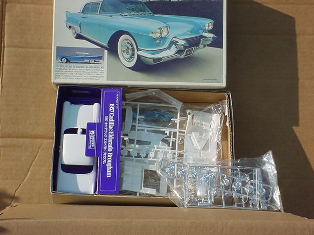

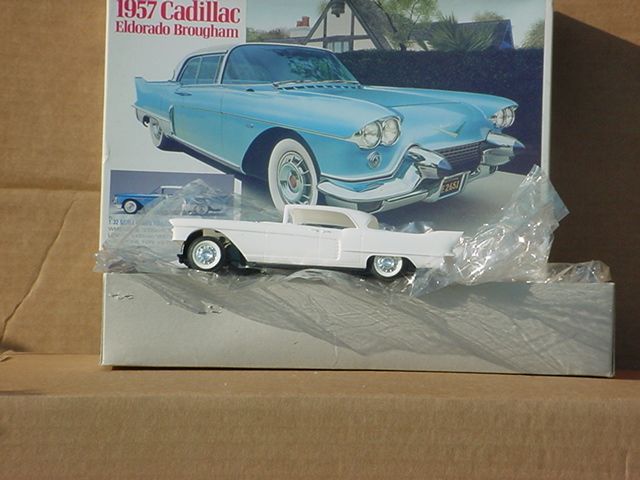

Edsel-Dan Posted February 15, 2015 Posted February 15, 2015 I have Both kits, The Revell SSP, And Gunze's 1'32 I can tell you that the Gunze kit, while having a 1pc Body, uses the 59 Biarittz Chassis, seats, dash & Steering wheel UNALTERED The Sombrero caps are the same too, but were on the Actual cars!!! (At least in the pic's above) here is one of my Gunze 1/32's: and the second You might even see the 59 Biarittz's Boot cover is Still on the tree too!!
