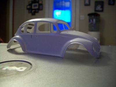

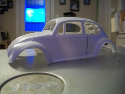

restoman Posted February 24, 2015 Posted February 24, 2015 This is going to be my first full-on custom build... Starting with Revell's Street Machine kit. My plan is for a lot of work... top chop, shorten the body, custom built pick-up box, lots of trim shaving, Fuch-style wheels, etc... hopefully ending up with something that looks like pic #2. Thinking about the same colour too.

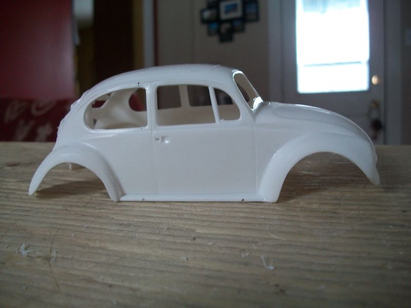

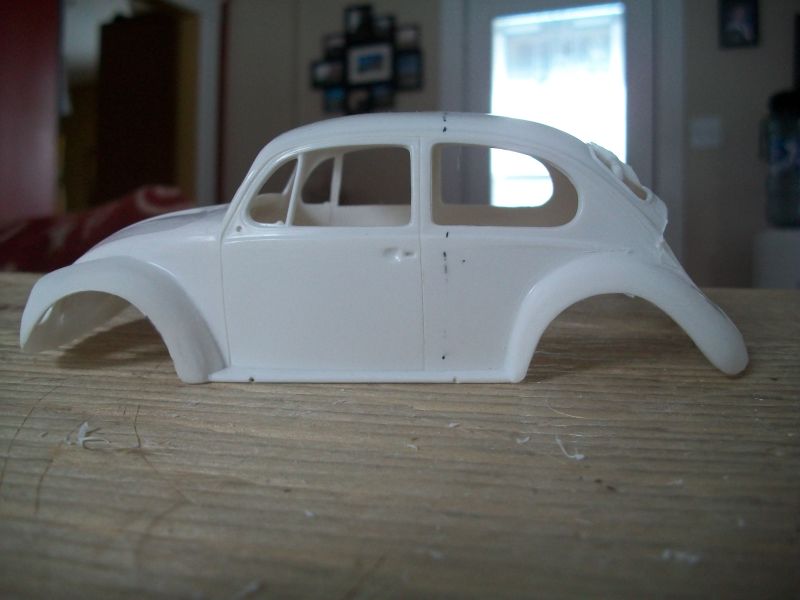

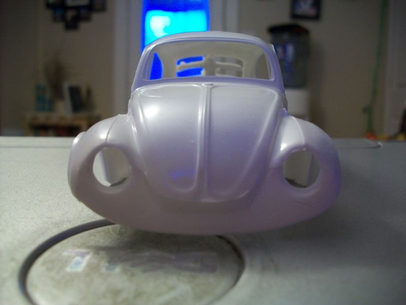

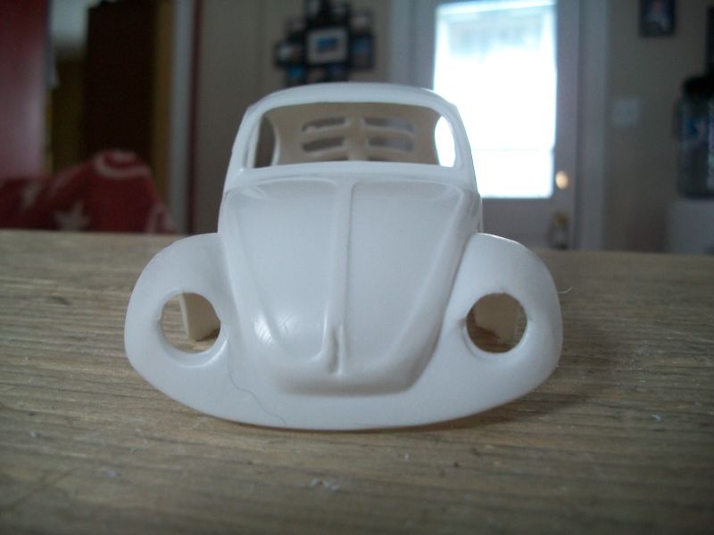

restoman Posted February 24, 2015 Author Posted February 24, 2015 This is a really rough body. lots of flashing, sunken areas, mis-matched mold seams... First order is to get rid of those fender flares and get the wheel openings looking a little better. Some plastic is going to be needed to get the front view better.

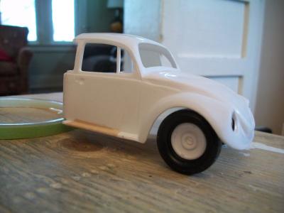

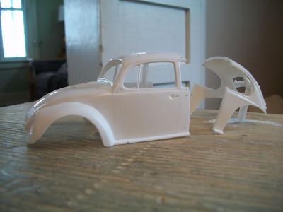

restoman Posted February 24, 2015 Author Posted February 24, 2015 Spent an hour or so on it today... so far, so good. Now, the roof looks really high! A chop is a must!

southpier Posted February 25, 2015 Posted February 25, 2015 you've got the start of a great 5-window cab - just sayin'. . .

Eric Macleod Posted February 25, 2015 Posted February 25, 2015 Neat. This is going to be very interesting. I like the 5 window cab idea! E-
rsxse240 Posted February 25, 2015 Posted February 25, 2015 you've got the start of a great 5-window cab - just sayin'. . . I was thinking the very same. I love the idea! Can't wait to see more. I may take the idea and do the same with some bugs I have laying around.

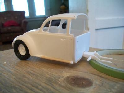

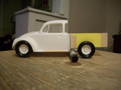

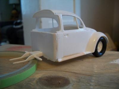

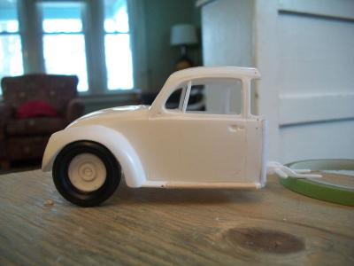

restoman Posted February 26, 2015 Author Posted February 26, 2015 Spent some time mocking up the engine and transaxle to determine the stance. I think I'll end up sticking with a slightly lower than stock height. it's an awful lot of work to alter the chintzy suspension that's on this kit. Also mocked up a box to get an idea of how much to take out of the roof height. Going to shorten the box slightly and lower the top rails a touch. Beetle rear fenders are going on the box.
