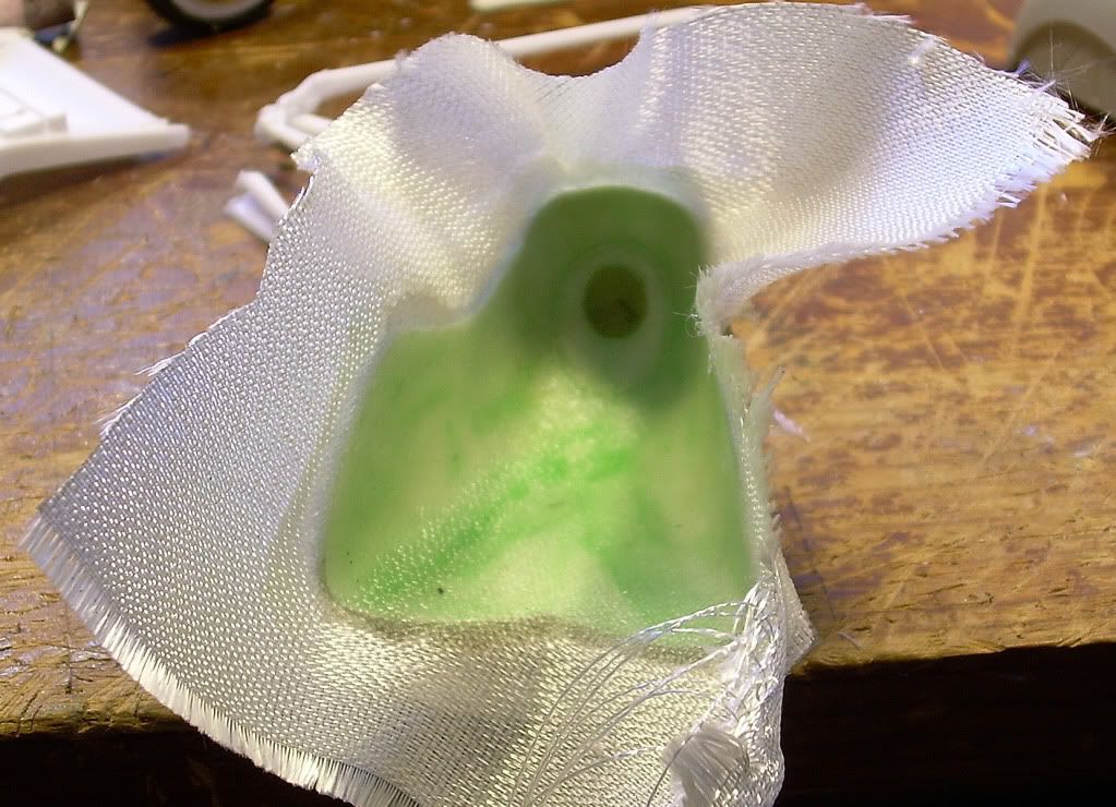

Ace-Garageguy Posted February 27, 2015 Posted February 27, 2015 (edited) Vacuum forming has been a staple technique of the modeling community for many years. Though it has some advantages in allowing the fabrication of close-to-scale-thickness parts, it also has several disadvantages. The fact that details don't form crisply with most vacuum-forming processes (which usually form the part over a "positive" mold) is one major drawback. I've been experimenting with making close-to-scale-thickness fiberglass parts since 2005, and have the process pretty well worked out. It has several advantages over vacuum forming, chief being that it requires no heat, and as the parts are formed in "negative" molds, sharp details reproduce perfectly. My fiberglass parts that are .020" thick are at least as "strong" as injection-molded styrene parts, are of consistent thickness (if you do it right) and will take a great deal of handling and abuse during finishing. These early parts are about .030" thick, and will take very rough handling. In the mold... Edited February 27, 2015 by Ace-Garageguy

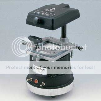

Belugawrx Posted February 27, 2015 Posted February 27, 2015 I've been looking at Kijiji(ebay) used dental vacuforming machines for only $90. - $100. The ones they use to mold dental implants. Work surface ...about 5" X 5" Could get some windshields and smaller parts formed
rsxse240 Posted February 27, 2015 Author Posted February 27, 2015 I was thinking of items like windshields, inner fenders, radiator core supports, inner door panels and other blobby looking shapes that are either pressed or formed in a mold in 1:1. I realise the lack of detail that is inherent in vacuum forming, but if you remove all the wires, hoses, bottles, clips and the sorts from a real car, you're left with blobby looking shapes therefore vacuum forming would be great. However the fiberglass thing is way friendlier to the average do-it-yourselfer.

Belugawrx Posted February 27, 2015 Posted February 27, 2015 Yep that's the one Joe Now I gotta get one!!

rsxse240 Posted February 27, 2015 Author Posted February 27, 2015 I have seen all of these being positive bucks in the vacuum forming process. If one were to make a negative buck, with the right kind of plastic, would you not be able to get finer details? Or possibly couple vacuum forming with Bill's fiberglass process to yield highly detailed very thin, rigid forms? When making fiberglass and carbon fiber auto, aircraft, or other type of panels, they use a vacuum bag or similar (depending on the part) processes to squeeze the air from the multiple layers and to press the resin into the details of the molds. Could this process be beneficial to yielding finer details with the fiberglass method? you could get some really nice details on a body, such as trim and body lines built on to your wooden buck, so as to cut down on detailing time on the working panel. Plus you could change the details on the buck and make several molds with varying details such as louvers, different grills, door panel shapes, etc. Ok, I'm getting lost in my imagination here. I know this topic has me thinking and new (to me) ideas are popping up. I hope you guys are getting as much out of this as I am.

Ace-Garageguy Posted February 27, 2015 Posted February 27, 2015 When making fiberglass and carbon fiber auto, aircraft, or other type of panels, they use a vacuum bag or similar (depending on the part) processes to squeeze the air from the multiple layers and to press the resin into the details of the molds. Could this process be beneficial to yielding finer details with the fiberglass method? you could get some really nice details on a body, such as trim and body lines built on to your wooden buck, so as to cut down on detailing time on the working panel. Plus you could change the details on the buck and make several molds with varying details such as louvers, different grills, door panel shapes, etc. Ok, I'm getting lost in my imagination here. Your thinking is right on the money. I've been building vac-bagged glass and carbon parts for years (for 1:1 aircraft and surface vehicles). Carbon HAS to be bagged, as it is so rigid it simply will not follow any tight curves otherwise. Vacuum-bagging COULD be used to advantage on model glass parts, but adds a level of complexity that's not necessary for scale parts with the techniques I've developed. My parts have gone from .030" down to .010", and are still tough and can be finished using conventional processes. Surface details are reproduced perfectly, every time. Notice the surface details present on these parts and molds.
