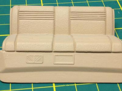

I have searched google AGAIN and cannot find any reference for this question... What we call a parcel shelf over here you americans refer to as a rear package tray, that much I found out. But I can't find any pics of the stock versions. Do anyone know if they were just covered in the same vinyl as the seats/doors etc? Were they carpeted with the same stuff as the floor?
Also this AMT kit has a speaker and boot vent(?) detail on it (pic below). Were these chrome or black or coloured the same as the vinyl interior?
Thanks in advance for anyone who replies :)

The "vent" on the left is a rear window defogger.
The covering (IIRC from being around a lot of old GM '60s cars) is usually 1/8" hardboard with a laminated leather-grain finish colored to match the interior.
Edited by ChrisBcritter
What Chris says goes with the old Chevys I have been around. The 69 Camaro my buddy was restoring had that vent as an option it was black just like the rest of the interior was. These were an option so you could sand it off if you wanted to.
Ah thanks Chris. Just the answer I needed.
Yeah Andy I could sand them but don't wanna screw around with the paint now. I might either flock over them or just give them a detail wash.
Thanks for replying dudes :D
